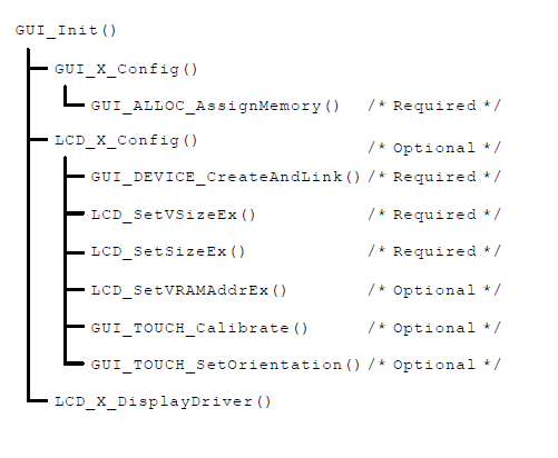

set breakpoint at the function
GUI_ALLOC_AssignMemory
GUI_DEVICE_CreateAndLink....
You can determine the function on which the program hangs
