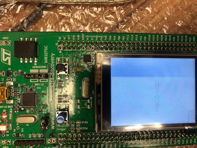

When running under the debugger (or after code has been loaded and the system has been reset separate from debugger), the screen is flickering as if some other set of data is being interlaced. You can see the "hello world" and some other minor text/graphics that were added to it when it is doing this. It looks like this:

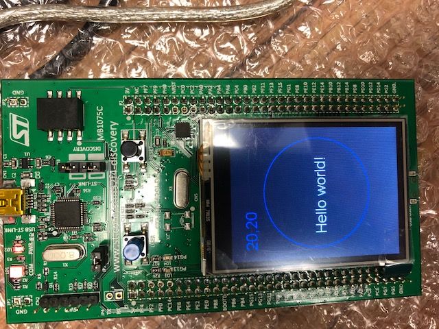

However, if I run under the debugger and then halt the debugger, the flickering stops and we have the expected image:

This person also had the same problem. Fix is to reduce the LCD clock frequency (reduced mine by a factor of 4 (/2 to /8 on last divisor). Works now.
