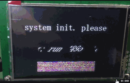

stm32f401rct uses partial framebuffer to display skewed when refreshing the control,
victor.wu
Associate II
0693W00000Lz91nQAB.gifUsing threadx rtos, spi is written to st7796 rbg565 480*320, the interface display is normal during initialization, but it is abnormal when the widget is refreshed in handletickevent

victor.wu
Associate II
Does anyone know the reason, thank you very much for your help

victor.wu
Associate II
A workaround method is adopted here. A global variable is judged in the timer interrupt. If the writing spi tft thread has completed the transmission, it will be executed.

victor.wu
Associate II
From the phenomenon, it seems that the touchgfx kernel has data misalignment when rendering part of the buffer, and it has been repeatedly confirmed that the spi program written to the st7796 is correct.

victor.wu
Associate II
Confirm that the problem lies in the setwindows function, st7796_draw_rect(wr_x , wr_y , wr_x + wr_w -1 , wr_y + wr_h -1, (void*)pix); need to set x2, y2 minus 1, so the window is dislocated, thank you very much You, the partial buffers are really nice to use, and can take advantage of graphics on a low-cost chip.
