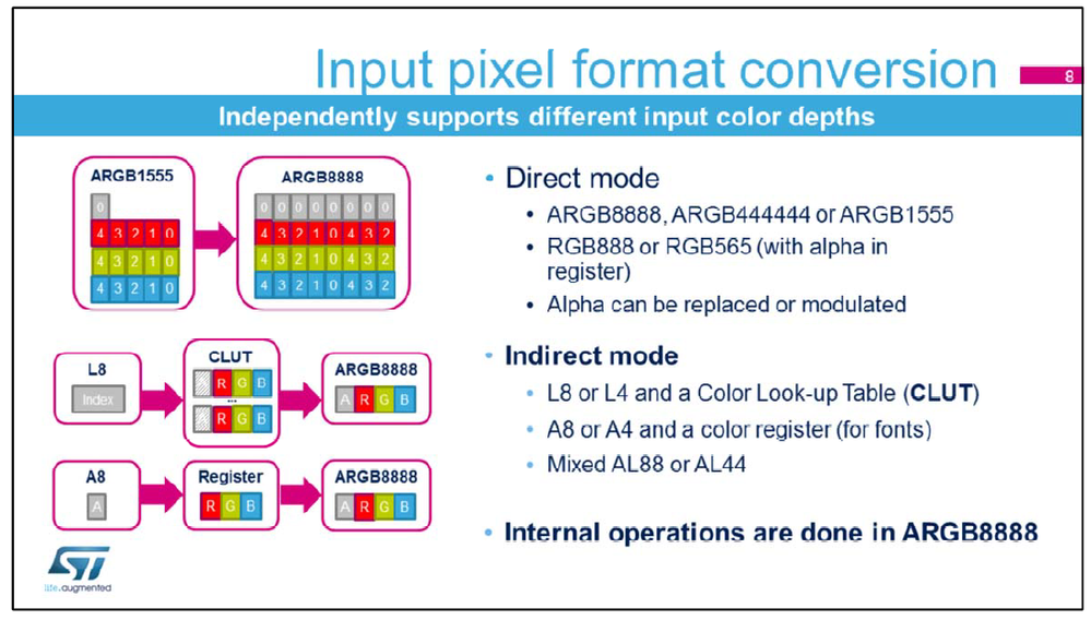

Thus, the blending between those two layers is supposed to display an anti-aliased character (in relation with the fixed color used). In one of those presentation made by ST, there was this picture :
So I don't know why, but I can't achieve this result (adapted to A4). Where am I supposed to set this ''color register'' ?

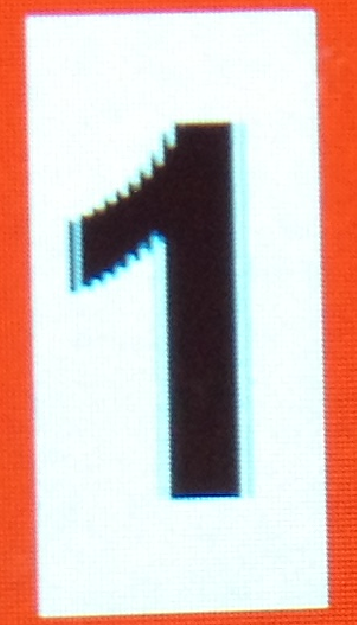

Anyway, even if it barely works, I have the feeling that it doesn't work completely. Here is why :
I draw the ''1'' number on my display (100px height). Here is what I am supposed to get :
And here is what I get (do not focus on the red color) :
Sorry for the quality of the picture. As you can see (not easy I know), it is... strange when it comes to draw the border of the character. For example, at the beginning of it (left, beginning of the ''1'' curve), there is on my screen one vertical black line (1px), then one white (1px) and black gain. Even on the right of the character, even if we can't see there easily, there is :
- All black on the vertical path ;
- A vertical white line (1px) ;
- A kind of grey vertical line (1px) ;
Do you have a solution ? This result is from the blending operation, which is not possible to see for the user. But I don't understand why I have white pixel where I am supposed to have black ones (or black ones where I am supposed to have white ones).
EDIT 2 : Sooo, after some thinking I figure it out why my characters are not quite drawn as I expected. The issue seems to be the way the DMA2D peripheral fetches data. As I explained before, my characters are A4 formatted. For example to draw two pixels (side by side on the same line) in A4 format I need one byte. Let's say 0x0F : 0 is the alpha channel of the first pixel. F the alpha channel of the second pixel. At least that's what I thought. Actually, when the DMA2D fetches data in memory, it associates F to the first pixel and 0 to the second pixel. This way, there is an inversion. Every two vertical lines are inverted. The result if this inversion is the picture above. I tried manually on a character to ''reverse'' every 4-bit in a byte and my character was as I expected.
So my new question is : is there any way to change the way DMA2D fetch A4 formatted data ?

The color for A4 mode is assigned in the DMA2D->FGCOLR + DMA2D-> BGCOLR register.
The brightness control in A4 mode is one bit. The bit is set to 1 - the color of the register DMA2D-> FGCOLR, the bit is zero - the color of the register DMA2D-> BGCOLR. Transparency management one bit alpha A4, + 1 bit color A4 = 4 gradations. Separately for each color. The total alpha for the top layer DMA2D-> BGPFCCR (multiplication or addition) affects all the upper layer registers, the letter can be made semi-transparent with the original four gradation levels preserved.The use of multiple variables often gives a glare or complete darkness. You can use the documentation, you can achieve the result by experience.But the main thing, the separate influence of the alpha channel on each color - imposes a restriction on the order of building the physical color points on the screen. The screens with the reverse color construction (BGR) will have a distorted image. This will happen when the screen is flipped, regardless of the software correction.And yet - how did you manage to create data in A4 format? All that I met - he does not know how.
