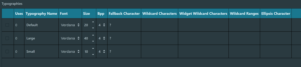

In the Designer, you will find the Typography tab as below :
You can see that the typo is 4bpp. But if you have a 1 bpp display configuration for instance, you will have a conflict. In this case, you can lower the bpp for the typos.
/Alexandre

Originally I had set a 1bpp color format, also in typographies. The simulator project builds an runs ok.
