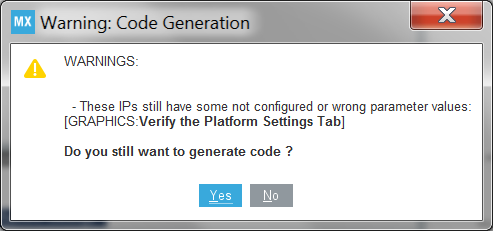

Hi. The integration between TouchGFX and CubeMX 5.0 is quite complex. Recent attempt of a combo project is able to compile without errors on IAR but the GUI generated with TouchGFX results in a blank TFT display on this kit. Guessing something to do with the LCD display and will attempt to debug.

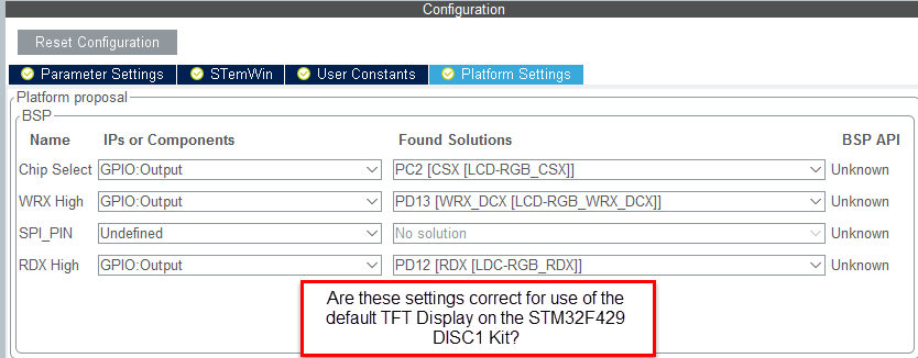

CubeMX is complaining about the Platform Settings so is the issue with the SPI_PIN?

After 3 weeks of daily struggles, have this now working correctly on the STM32F429I-DISC1 target using both, the CubeMX and TouchGFX toolchains. Will review the process from scratch again to be sure that we are not hallucinating and will post a document detailing the steps.
2018-12-17 3:05 PM
Hi. Here is the first draft document of the full procedure to support the STM32F429i-DISC1 target that we followed:
https://s3.amazonaws.com/axxonshare/my_combo_tutorial.zip
Welcome feedback on this document and if it works for you. Good luck! :grinning_face:
