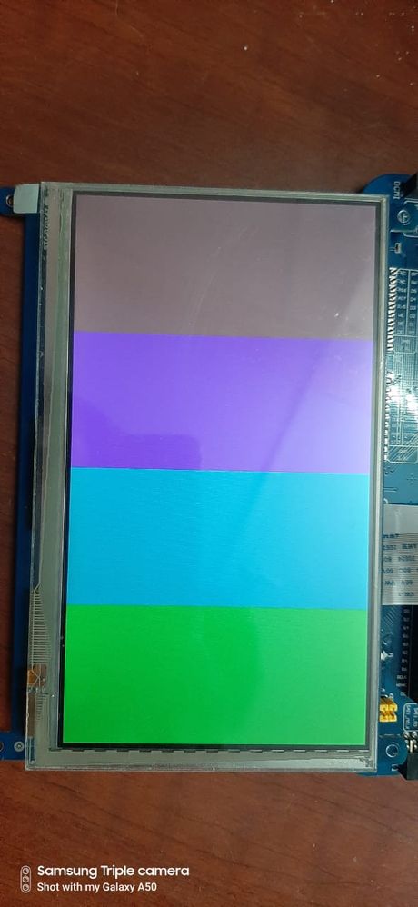

I am using STM32F746IGT MCU ( Waveshare Development Board ) and 7Inch Display
(1024x600)
Software are using " STM32CubeIDE 1.6.0 " and " TouchGFX 4.16.0 ".
I am Just create screen_1 (one color Box and one button) in TouchGFX
Configure in STM32CubeMX :
I am facing problems :
While Debugging " SystemClock_Config() " then go to " TIM6_IRQHandler ".
2 Without using Timebase Source
While Debugging " osKernelStart() " then go to " HardFault_Handler ".
After upload ( Debugging) What's my display shows image mentioned bellow for your reference .

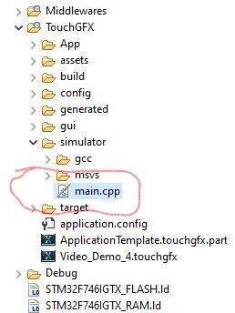

And in STM32Cube IDE main.cpp file show hide, that screen short also attached below
Please give me a idea for rectify my problem, I need to developed my own GUI using TouchGFX .

At 2 main.cpp is only for PC Simulator and in CUBE is excluded OK

2021-06-11 2:02 AM
As first you comment out start RTOS and in main test your framebuffer and LTDC config.
For example in main while wait press button and fill framebuff with an colour, then next usw.
And when you use custom display you cant find display driver, but you need WRITE one.
When you connect RGB display then your connector need all signals and too init over for example SPI ...
