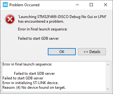

I rebuilt the program OK< but when I loaded into the debugger and ran it, I had some kind of failure (and the operating current was not normal). Now every time I try to run the debugger, I get this:
I think my development board is fried!

Well, I reverted to an older version of code, got everything working on a different board, then tried to load it onto the original board. STILL got the same No Device Found on Target error.
Did some searching, and someone at stackoverflow suggested the following:
1) Go into the STM32CubeProgrammer.
2) Hold down black Reset button on Dev board.
3) Press CONNECT button in STM32CubeProgrammer to connect to device.
4) Release reset button.
This recovered my board! I can now load the older version of code into it.
2022-05-05 10:42 AM
OK, now I get why this happened. I set unused pins to analog in the project manager without first reserving the SWCLK and SWDIO pins for debug!
And it seemed like such an innocent little checkbox ;)
