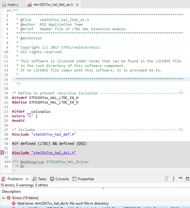

I am trying to compile the generated code from STM32CubeMX that already has an activated X_CUBE_TouchGFX package with no success.
there is a lot of missing files! so I did generate a project using the TouchGFX Designer and tried to add all the missing files to my project, this partially solved the problem, cause there are files that include the DSI driver.
the microcontroller I am using is STM32H747XI and I believe that because the evaluation board for this microcontroller "STM32H747I-DISCO " uses DSI mode the files using it is generated although the DSI peripheral is not activated on my IOC file and I still have errors that header files is missing and don't know how to fix it!.
In general, how can I create a new TouchGFX project for my custom board that uses STM32H747XI microcontroller without the DSI peripheral, instead I am using an RGB interface with the LCD?

First of all, thank you for your help.
I did deactivate the TouchGFX package from the IOC file and then created a new project using the IOC file but still, I got the same error, although the DSI is not activated on the IOC file still the IDE gives me an error cause it doesn't find the DSI driver header, see the attached screenshot.
0693W00000Kcn7bQAB.pngThank you

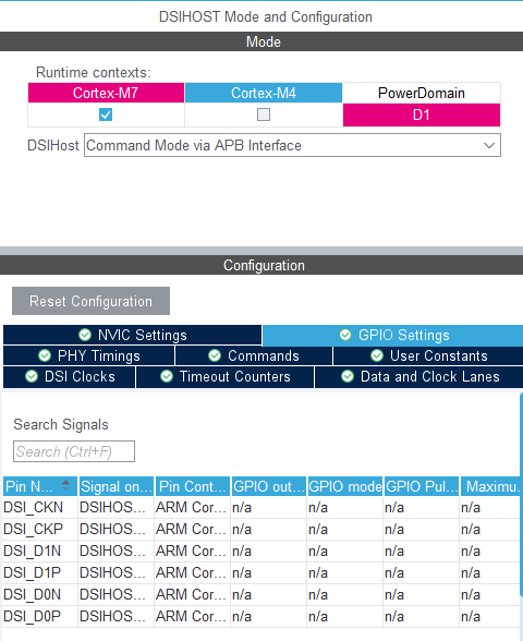

Hi Again,
I figured that the DSIHOST and LTDC is linked on the IOC file, either both are on or both is off,
This is the DSIHOST configuration that makes the problem:
0693W00000KcnQnQAJ.pngBut when I chose the DSIHost to be "command Mode via APB interface" (see the photo below)the build error disappears and the project compiles correctly, but I don't need the DSIHOST which already activates 6 pins, and I really don't know what this DSIHOST can help me with when my LCD interface is RGB 24 pins and it's not MIPI.

MM..1
Chief III
Seems as bug in MX. For solve copy file to project drivers
from
C:\Users\.......\STM32Cube\Repository\STM32Cube_FW_H7_V1.9.1\Drivers\STM32H7xx_HAL_Driver\Inc\stm32h7xx_hal_dsi.h
and next bug here is you need manualy mark all GPIO LTDC pins with alternate for RGBxxx.
DSI leave Disabled. MX wizard stupidly add only 12 from 28 GPIO LTDC pins.
