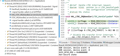

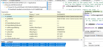

2024-10-03 2:25 AM - edited 2024-10-03 3:02 AM
Unfortunately I cant share my code since its proprietary, but I can give you the logic that I am using in my code.
I am using a RiverDI 5 inch display development module, which is having STM32 embedded in it. I am also using TouchGFX to program the 5 inch display. Basically my riverDI application contains multiple tasks, one for receiving the UART from the ESP board and one for updating the display through touchgfx APIs. To share the received UART data between my UART task and touchgfx task, I am using a message queue, where the UART task puts the data in the message queue once UART Rx is received from ESP and TouchGfx task gets the data every ticks (1ms) and displays in the screen.
UART task snippet (when the UARTRx is received):
TouchGfx task snippet:
The hardfault is occurring in the subsequent calls of osMessageQueueGet() as I shared in my previous comment.
Regards!

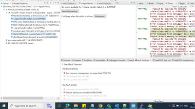

Hello Mohammad,
Thanks for looking into my post. To isolate the issue, I removed the message queue implementation and tried the direct copy through extern variable. But the hardfault hits in a different API now. Any ideas?
Regarding reinit: Sometimes our app doesnt get the UART Rx packets, so I had to reinit to refresh the communication and continue receiving the uart rx packets.

HI,
I do have the UART Tx in a task and the UART Rx is with interrupt mode. When the UART receives the interrupt, I parse the data and put it in a message queue, eventhough if the UART reinit happens or not, the messagequeue will be holding previous data, but its weird its hardfaulting. I tried to wait in the UART task when there is no Rx data after my ESP reset, but the hardfault hits in a different location like below. FYI, I have removed the reinit logic to test, but the result is still the same.
