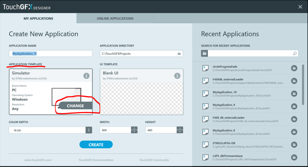

I don't know much about that demo sorry, but I can just point out that when you create a project in TouchGFX Designer, you can select the "Application Template" for the STM32F769 discovery board which will generate a pre configured TouchGFX project. If you wish to use Keil, you will need to open the generated ioc file in CubeMX, go to the "project Manager" tab and change the IDE/Toolchain to MDK-Arm. You will then need to generate code from CubeMX, generate code from TouchGFX Designer and then you can open the generated keil project.
You can also select a "UI template" which consists of demos and examples, and directly run the project on the board.

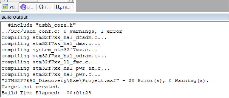

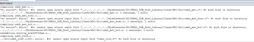

0693W000008yLxaQAE.png0693W000008yLxVQAU.png0693W000008yLxGQAU.png0693W000008yLxBQAU.pngHi Romain,
I download example in https://www.st.com/en/embedded-software/stm32cubef7.html.
I open the Audio_playback_and_record example in applications file, TouchGFX example in Demonstrations file and ADC example in Examples file, I rebuild them, they show errors. (MDK-ARM/Keil uVision5)

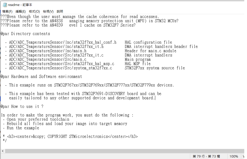

In the readme, it only shows:
" In order to make the program work, you must do the following :
 - Open your preferred toolchain
 - Rebuild all files and load your image into target memory
 - Run the example "
I confuse why these examples cannot be rebuild directly and show many errors. ( I did not modify anything.)
