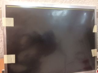

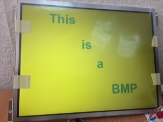

After that I made a simple 1024x768 BMP picture in GIMP (Green text "This is a BMP" on the yellow background), then I optimized it using Bitmap Converter, then converted it to C-array using Bin2C for GUI_BMP_Draw() function and finally got it on the screen:
Next I made a same GIF picture ("This is a GIF"), unoptimized it as described in emWin manual (exactly in emWin UM03001, not in StemWin manual StemWin532.pdf) then again used Bitmap Converter and converted the GIF to C-array for using with GUI_GIF_Draw().

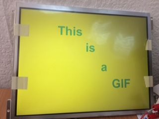

And got this one:
Seems that only few first lines of the GIF displayed. GUI_GIF_Draw() returned 1. That is error.

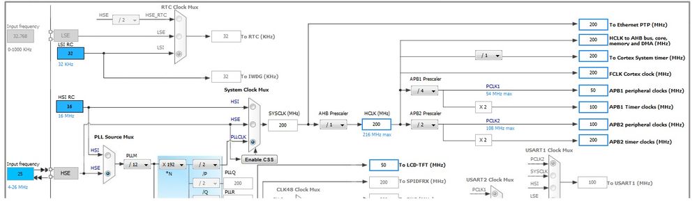

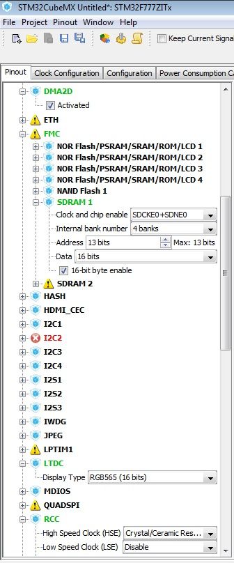

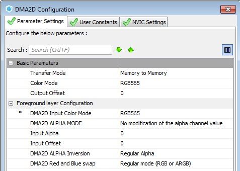

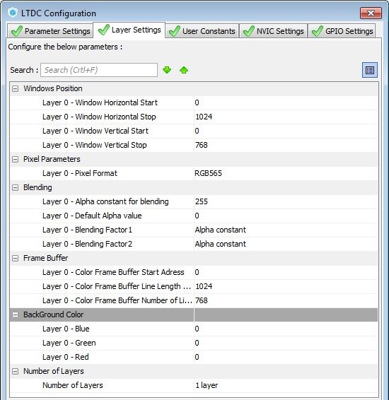

Some configuration screens from STM32CUBEMX.
Pinout:
Clocks:

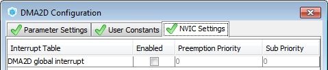

DMA2D:

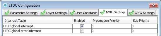

LTDC:
Color frame buffer start address for Layer 0 reassigned to 0xC0400000 in LDC_X_Config()

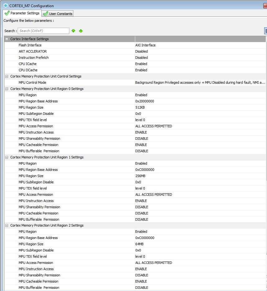

MPU:

It seems that problem is in MPU regions configuration as I'm using STM32F777ZI chip.
AN4861 contains recommendations how to configure the MPU regions in case of graphical memory allocation in SDRAM.
AN4838, AN4839 contains recommendations how to configure the MPU regions as such.
Cortex-M7 has a complex system to handle access to the memory regions. And I'm currently having a hard time configurating the MPU regions for SDRAM space.
