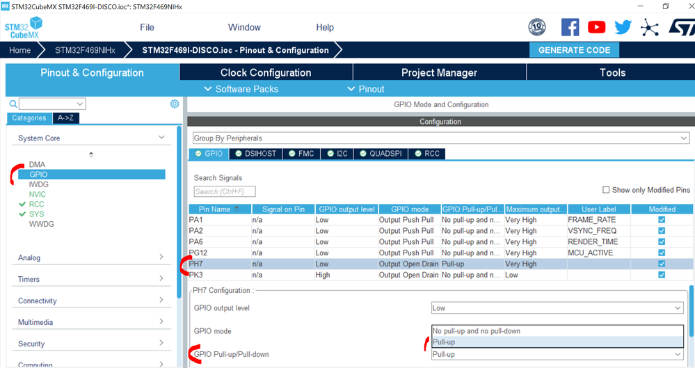

I was told that the difference with the latest revision B-08 is a change on the Touch Display circuit, where an out chip (out of microcontroller) pull-up resistor was removed from LCD_Reset Pin. This pin is connected to PH7. This is pointed in the User Manual UM1932.
Could you try to activate the internal pull up at this pin in STM32CubeMX as in the picture below ? Cannot guarantee it works as I do not have the board with me to test it.
/Romain

PH7 - with or without PULL UP - not working.
