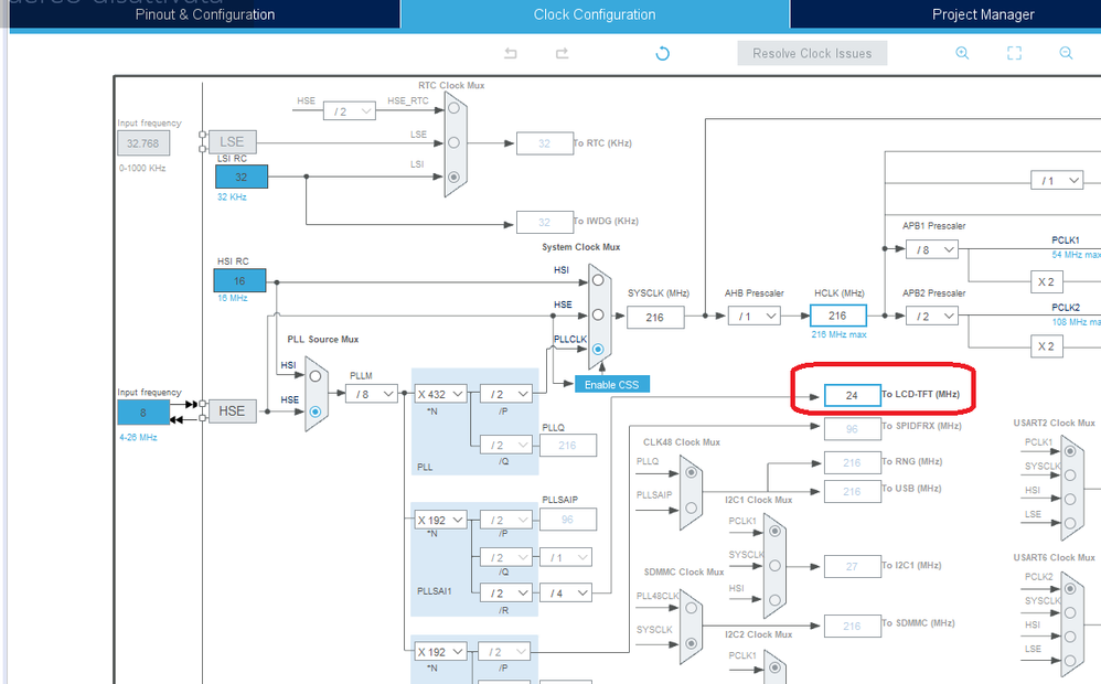

Hi @Martin KJELDSEN​
I had already modified the GPIO.cpp file for measurements.
The capture that I posted is related to the VSYNC_FREQ.
If I understand correctly, I can change the pixel clock via STM32Cube IDE Clock Configuration, as shown in the figure.
It's correct?
/Antonello

What i meant is that you can capture RENDER_TIME to find the time it takes to render an entire frame. You can use this to measure the time during transitions to get an idea.
Yes, you can change the clock like that, but through the derivative settings following the arrow (PLL).
/Martin

Hi @Martin KJELDSEN​ ,
sorry for the delay in replying: I was trying to better understand VSYNC_FREQ, RENDER_TIME and FRAME_RATE from Measuring Performace Knowledge Base.
Anyway, I doubled pixel clock (from 24Mhz to 48Mhz) but "TopMenu" transaction does not seem to accelerate.
In the attached image, VSYNC_FREQ and RENDER_TIME when I "touch" to display slidemenu
/Anonello
