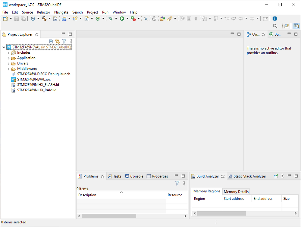

I am creating a project for the STM32F469I-DISCO board, and trying to open it and build it in STM32CubeIDE. It appears that TuchGFX Designer is not creating correct file names. Some have -EVAL instead of -DISCO, and I think this is causing problems. You can see both in the project below. All I did was open the .cproject file in the TouchGFX project folder. It does not find the ioc file, because it is incorrectly looking for a -EVAL and the actual file is a -DISCO file.
I'm assuming this is a bug in TouchGFX Designer because it is mixing up the two types of boards (-DISCO and -EVAL)?

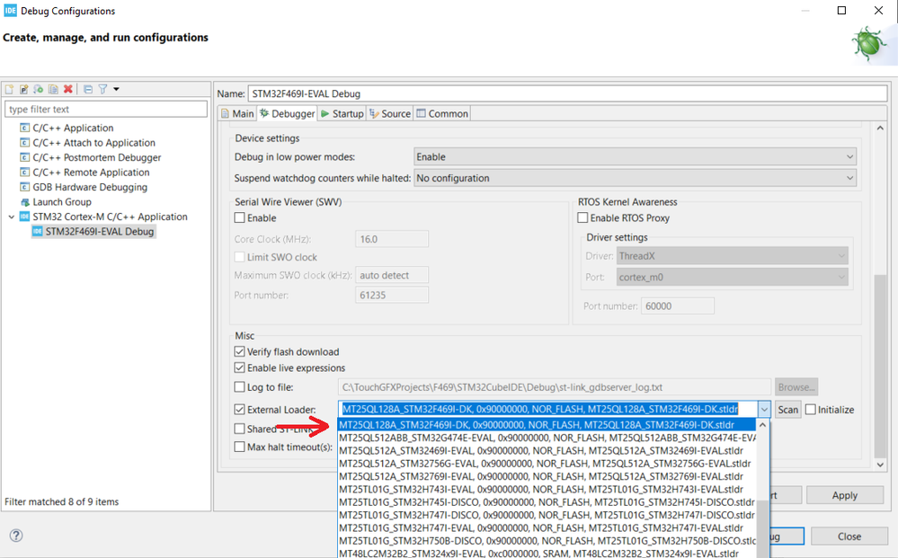

It built, but it doesn't run. I get a lot of ST-link activity like it is programming flash, then it says:
Debug connection lost.
Shutting down.
2021-11-19 1:17 AM
I don't have this STM32F469I-DISCO board to test.. but please check the flasher configuration in CubeIDE and select this one:

After getting the bad background color from using version 3.0.4, I went back to my original project and repeated what SofLit suggested (at least part of it - the flash configuration that was pointed out did not exist). This time I was able to compile with no errors and run the debugger.
