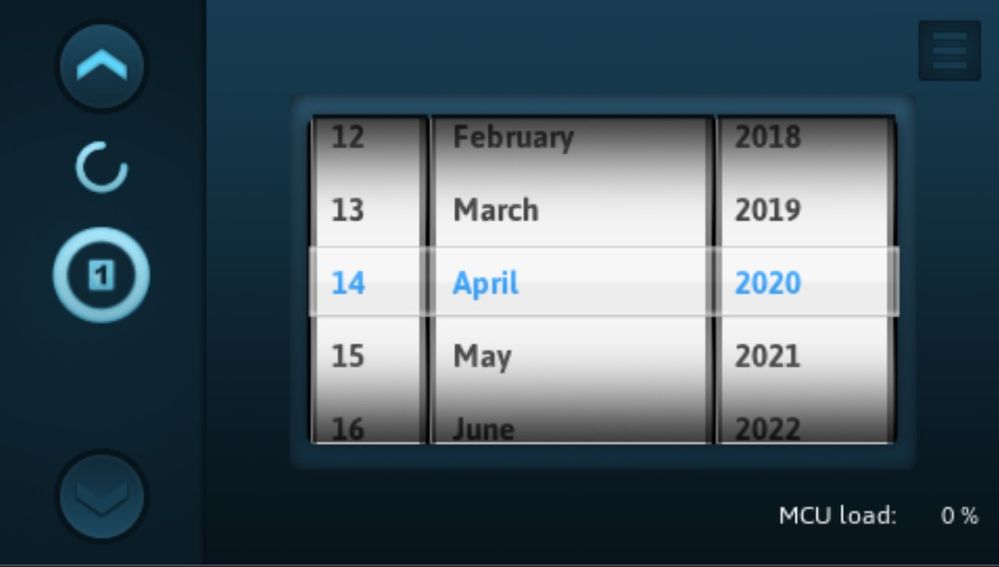

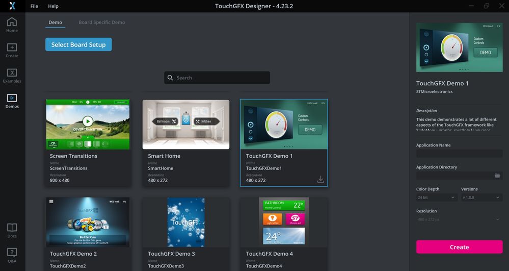

I think what you are looking for is pretty similar to a date picker. You can see one example shared by @Juliette CRESPO here , and also there is another one available in TouchGFX Demo 1.
TouchGFX Demo 1
Date Picker in TouchGFX Demo 1
