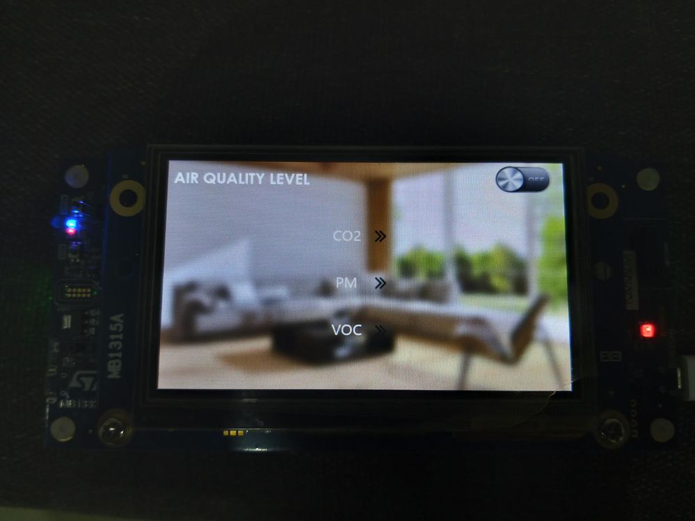

current screen:

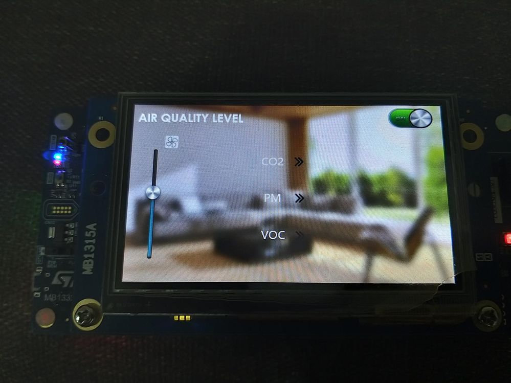

toggle-button pressed, the slider will appear, and setting the slider to half-way:

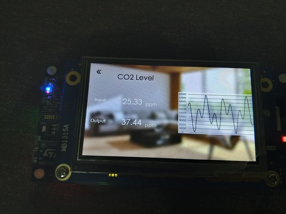

transitioned to another screen (co2 screen in this case):
Now ill press the back button here and ill go to the original screen again, at this time the screen state has to be like image 2 but it is not it is resetting to default like:

Don't worry that is completely normal. In fact, only one screen at a time is allocated so when you switch to another screen the previous screen data is deleted so when you come back it will be reinitialized. To avoid loosing data you need to use the MVP architecture and save your data in the Model.
Please have a look at this tutorial.
