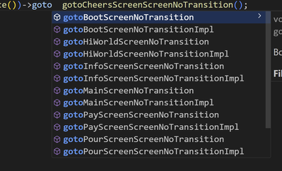

it seems that unless I make some transition to a specific screen within touchGFX (i.e. a button changing another screen to the screen in question), then TouchGFX does not generate any code for that screen (view, presenter, etc).
I guess it makes sense in order to save memory. But I want to transition to that screen programmatically so I do need all the code to be generated for that screen.
Is there some other way to force TouchGFX to generate the code for that screen?

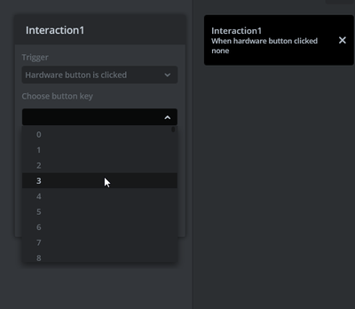

You could create an interaction where the trigger will never happen and the action is to switch to screen X, this way you get your code generated.
One way to add a trigger that will never be called is to select the "hardware button clicked" (as long as you don't use a physical keyboard in your final project):

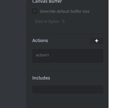

Alternatively, you could create an action on the screen and use that action as a trigger (this action will never be called if you don't do that yourself) :
