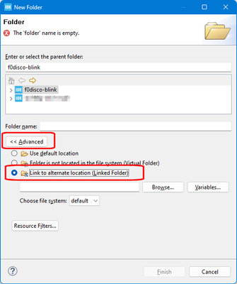

Now, in the CubeIDE's 'Project Explorer', right-click one of your projects, and choose New > Folder
Click on 'Advanced', then check 'Link to alternate location (Linked Folder)':
then you can browse to or type-in the location of your common folder.
Repeat for your other Project(s).

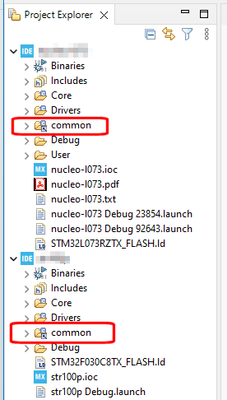

Then the CubeIDE's 'Project Explorer' will show the common folder within both (or all) of your projects:
But note that the common folders don't have the 'C' on them - which would mark them as Source folders.

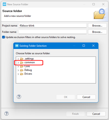

To fix this, in the CubeIDE's 'Project Explorer', right-click one of your projects, and choose New > Source Folder
The common folder will now be available to choose:
So choose it.

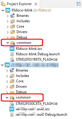

Now you will see that the common folders do have the 'C' added:

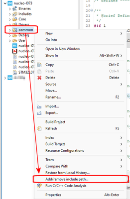

If you have headers in the common folder, you will need to update each Project's Include Paths.
Simplest way is to right-click on the folder, and choose 'Add/remove include path':
Repeat for each Project.

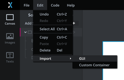

You'll need your specific application that you already have for your boards. Additionally, you require a third project based on the TouchGFX simulator to manage your GUI. You can then import this GUI into your specific board application by navigating to Edit -> Import -> GUI from within your hardware project.
Importing a GUI to your project
