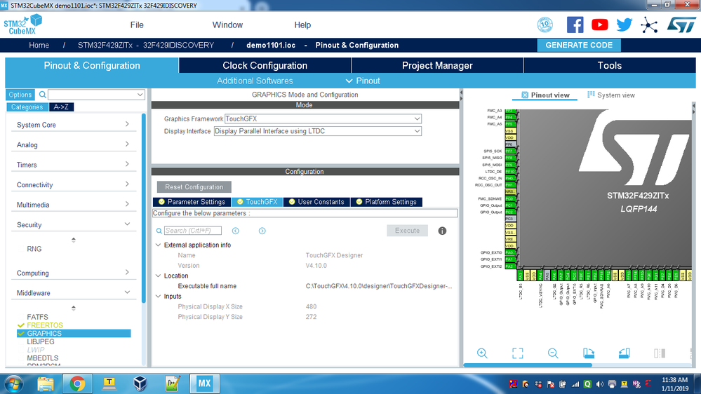

I am trying to enable TouchGFX configuration for CubeMX project.
The development board I am using is STM32F4 board.
I am stuck at the "Execute" option, as it is disabled for TouchGFX configurations.
Can anybody please tell me how to enable it?
Attaching the screenshot herewith:

Hi @kvkhekale,
What does CubeMX tell you when you hover your mouse over the "Execute" button?
You can also try to follow this guide:
https://touchgfx.zendesk.com/hc/en-us/articles/360021620431-Configuring-STM32F429I-DISCO (Based on IAR, but it should at least get you to the Execute part)

2019-01-11 5:34 AM
You may just need to just refresh this page. Select a different tab and then return to this page. That should enable the EXECUTE button so you may select and launch this tool.

I have the same problem. The button was enabled once and if I create another project it stays disabled.
2019-04-28 5:37 PM
@hansd56 , this behaviour may be correct with this tool. The reason being that the EXECUTE button should only really be used one time to initiate and build your GUI.
If you launch the tool a second time, the GUI values get factory reset. This is currently a bug that may be under development for future releases. So it is quite possible that is the reason the EXECUTE button is disabled by the s/w after first time use.
Instead, if you must continue to work / update with your GUI, launch the project directly and manually by locating the folder with this TouchGFX project.
