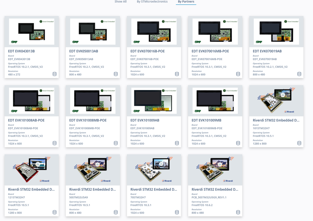

You could go for an ST discovery kit. The STM32U5G9J-DK2, STM32H7S78-DK and STM32N6570-DK have the same 5" display. They are roughly listed in increasing performance order, although the U5G9 supports full hardware acceleration of vector graphics.
If you are looking for third party displays with out of the box support, there are these partner displays with integrated MCU:

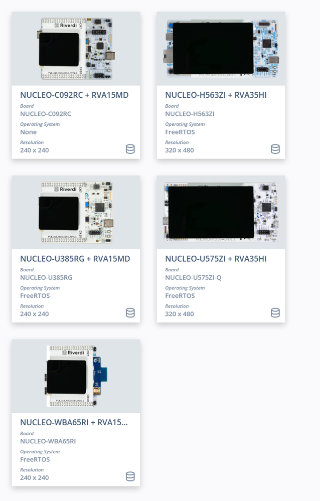

If you want a display and a separate Nucleo board, these options are available, although they are smaller than the requirements you listed:

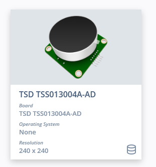

Finally, there is support for a knob style display from Team Source Display:
