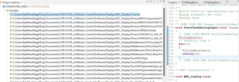

The PollingRoutines.h header file is in the project's includes path. Specifically, in the one highlighted:
I'm unsure what's causing this error, since PollingInit are defined in PollingRoutines.h, which is in the project's included paths. Did I miss something?
