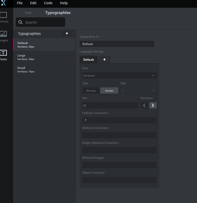

But then, in TouchGFXDesigner, you have to navigate to Texts>Typographies and select for which typography you want to use Vector Fonts, like here :
Hope this answer the question :)
