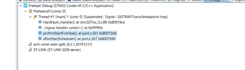

I'm working on a project with an STM32F746BGT6 microcontroller with external RAM and nor-flash memory. in the CubeMX, I configured FreeRTOS version 2 and have two tasks (128 words + 8192 words) and LTDC configured correctly (I believe) with TouchGFX. when I add "MX_TouchGFX_Process()" to the task, the program crashed and I get the following Error. But when I commented out "MX_TouchGFX_Process()", the program run correctly (I tested with LED blink).
attempts to increase stack size with no luck :persevering_face:. noted that I updated the TouchGFX to 4.16 (not 4.16.1), maybe the issue caused by the new release (God knows).
Any help will be appreciated.

As I said before, I am working on a custom board for this project. after I change the board with the same code on STM32CubeIDE, Suddenly I've got the same error as the new PCB! and can't figure it out, Could you please help me get rid of this error? Any suggestion?

After some testing and debugging, I load the first Screen(main screen) successfully, when the program wants to change the screen from Main to Second the error pops up! (My program consists of 10 screens that programs start from the first one and after a 7000 ms delay, the screen changes to the second one so on).
My first guess is Maybe the problem is External SDRAM because when the program wants to change the screen, it will load the second frame buffer to the ram(actually this is my opinion) OR maybe bad PCB design! what are your suggestions?
