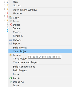

Cleaning Project
2024-08-20 6:52 AM
Hi Mohammad,
It doesn't seem to matter whether I run "Clean Project" prior to "Build Project". In the current state, the IDE runs two compilation flows regardless.

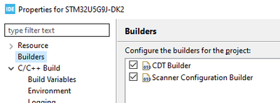

I tried disabling the Scanner Configuration Builder, but didn't seem to make a difference:

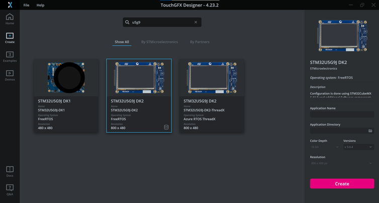

I cannot share the entire project in its current state since it is proprietary. Starting a new project from TouchGFX as shown in your screenshot above is basically how I did it initially, and should give the same results if repeatable.

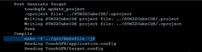

To my knowledge, both the IDE and TouchGFX have always used `-j8` in their compilation. Snippet of TouchGFX build below:

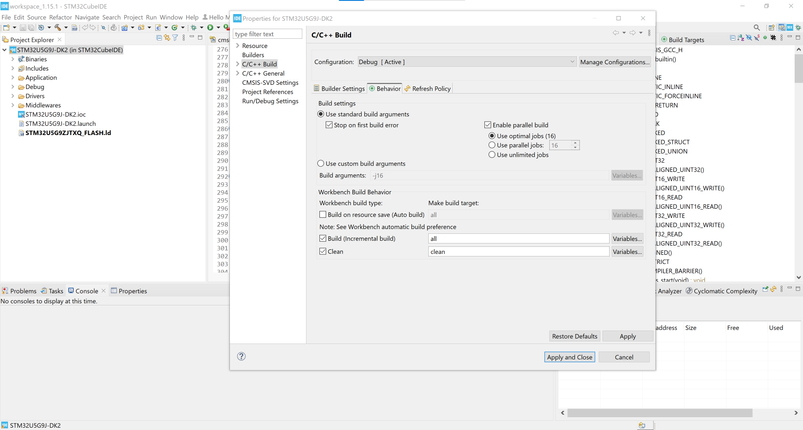

Yes, TouchGFX uses -j8, however, the default settings for STM32CubeIDE in C/C++ Build -> Behavior should look like this:
Default build settings used by generated project from TouchGFX
Although, I don't think the issue stems from these settings because I'm not able to replicate the issue you are talking about. And, as I mentioned earlier, from the error that you have attached, your custom-added files are not correctly recognized by the compiler. But, I don't understand how the 'second build' can be successful if there was an error in the first one.
