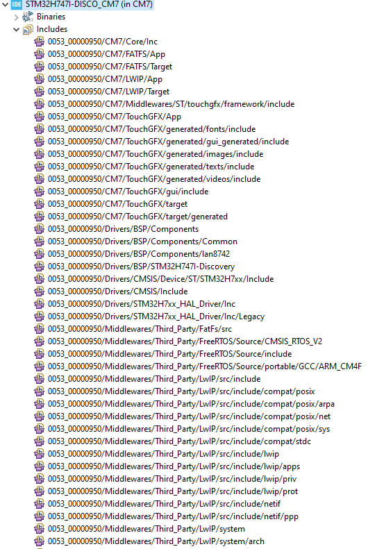

2022-07-11 11:59 PM
I didn't change the structure of my project. I just open the Project with "open Projects from File System", add my files to CM7/Core/Inc and /Src and generate a file link of my files in /Src to STM32CubeIDE\CM7\Application\User\Core. I didn't have problems with the link files, CubeIDE just can't see the code in your Project, when you open files outside of it (especially included files).
Here is a screenshot of my includes for comparison:
