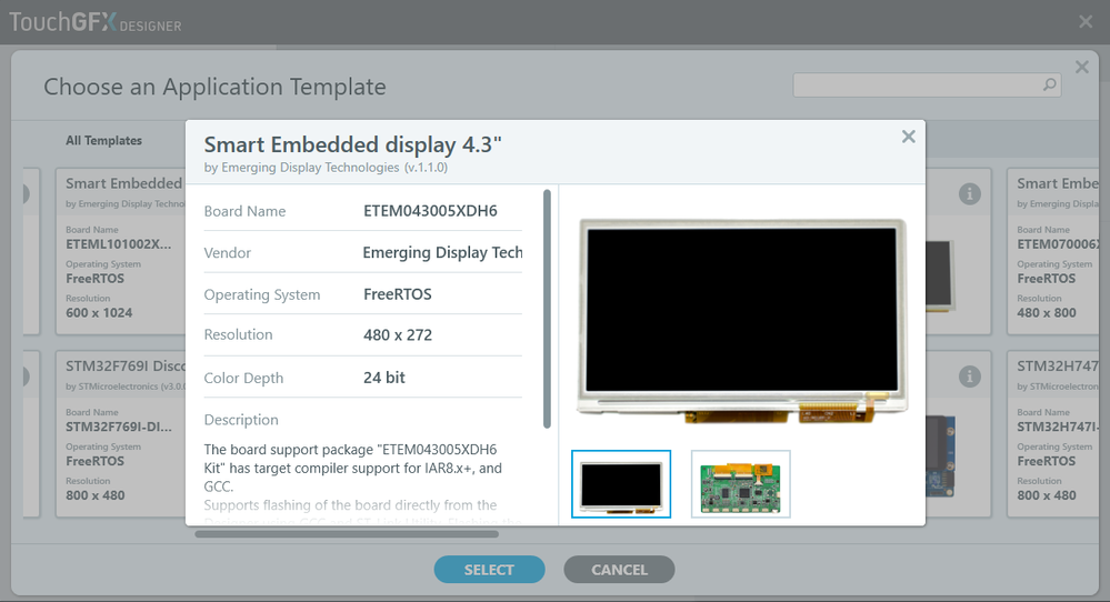

I'm using an STM32F746 based board from EDT (http://www.edtc.com/sb_readmore.php?id=23), which can be selected as an application template in the TouchGFX Designer and start from there with the IAR toolchain.

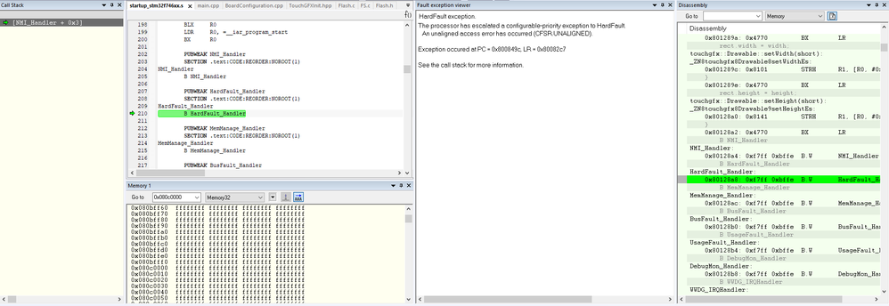

However, I've spent a good amount of time trying to debug it and I have noticed a few things that might help solving it:
pxTCB = listGET_OWNER_OF_HEAD_ENTRY( pxDelayedTaskList ); /*lint !e9079 void * is used as this macro is used with timers and co-routines too. Alignment is known to be fine as the type of the pointer stored and retrieved is the same. */
0x8008498: 0x6ea1 LDR R1, [R4, #0x68]
0x800849a: 0x68c8 LDR R0, [R1, #0xc]
0x800849c: 0x68c5 LDR R5, [R0, #0xc]This is the instruction that's raising the exception as the fault exception viewer says.
