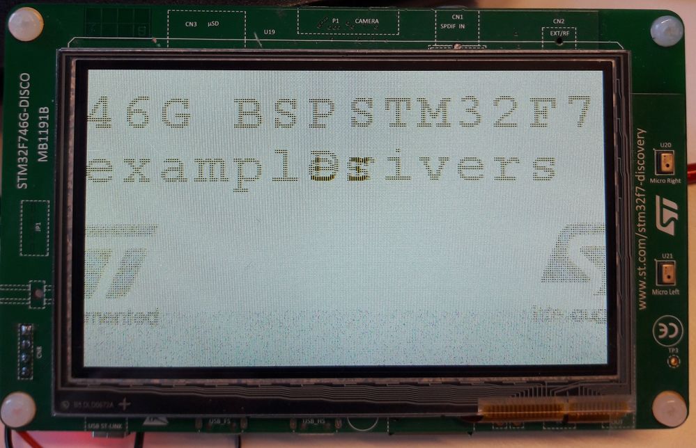

The display looks like the picture attached. Does anyone recognise this problem ?

I'm seeing some patterns on your screen that are reminiscent of offset issues - Do the colors make sense to you when you compare with the assets used in the application?

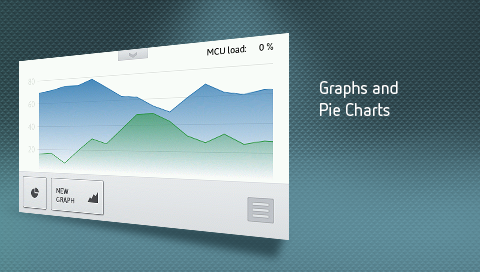

The colours do make some vague sense … and there is a "bar" along the bottom, which looks correct.. See attached asset.
When I touch the screen I do see some _very_ slight change in pixels at the top of screen....

I used System Workbench and got the result in the photo above. Yesterday I used MDK V5 and got a completely different, but still wrong result! See photo below.
