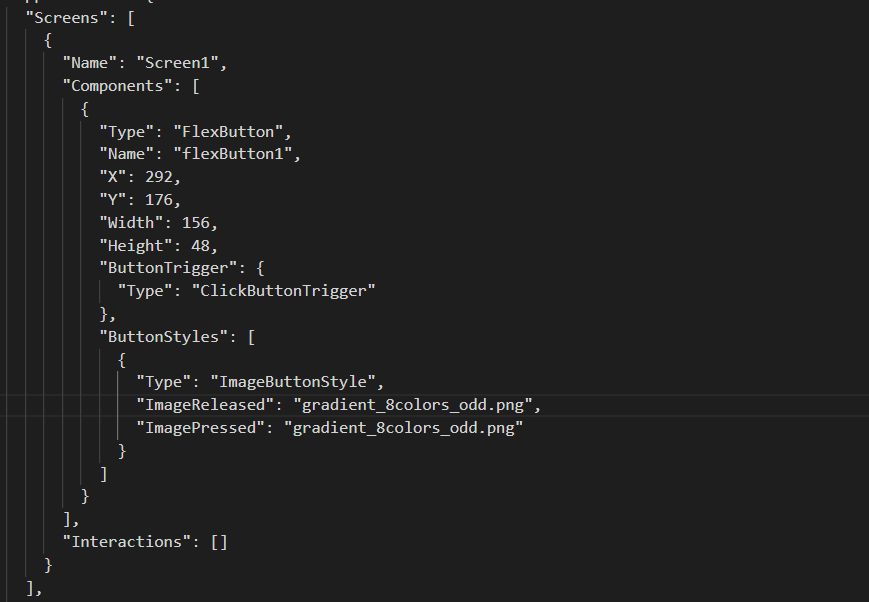

I'm trying to use images through the flex button, but, when i select some images, there isn't any visual update and selection update. I tried change the "released" image and continuous with "No image" after the selection in my library images.
anyone know about this problem?

Hello @FDigi,
That's indeed a bug, I will report it to my colleagues.
In the meantime, a work-around could be to open your .touchgfx file and modify the ButtonStyles>ImageReleased and ButtonStyles>ImagePressed paths, in order to insert the name of your image there. That will force TouchGFX to use your image, like this :
Sorry for the inconvenience,
/Yoann

Could you clarify a bit more the issue you are facing ? The "pressed" image is not properly displayed when you click on a flex button ? Do you face this on the simulator or on target ? Could you share your project or button settings so that we can replicate it ? (I think I did but just want to be sure we are talking about the same thing since I might have found more bugs as well :grinning_face_with_sweat:)

@Romain DIELEMAN when you create new flex button and try change the "visual Elements" with new image choosing a image for "released" state and "pressed" state, this component doesn't change the image through the designer software and after compilation in a board, but @Yoann KLEIN answered about the alternative for temporarly solution.
@Yoann KLEIN thanks for the solution, i will use like this for for now until a new version of TouchGFX is released.
