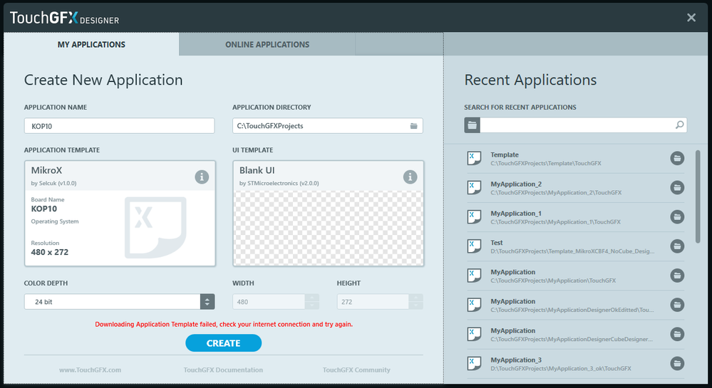

By following this guide (https://touchgfx.zendesk.com/hc/en-us/articles/115002741432-Create-custom-Application-Template) I have made an custom application template for our hardware. I'm able to select my application template in TouchGFX Designer (4.10.0) but when I press CREATE I get "Downloading Application Template failed, check your internet connection and try again". Does anyone have any suggestions?

}5. Copied the .tpa generated into the related directory. Run the Designer and tried to start a project selecting my template. Here is the result:
