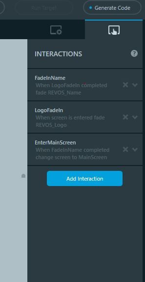

I have added below fade settings in touchgfx.
I m displaying logo and text "REVOS" for 1 second before main screen and during same time display is flickering. When I was storing data in internal flash, there was no such issue.
