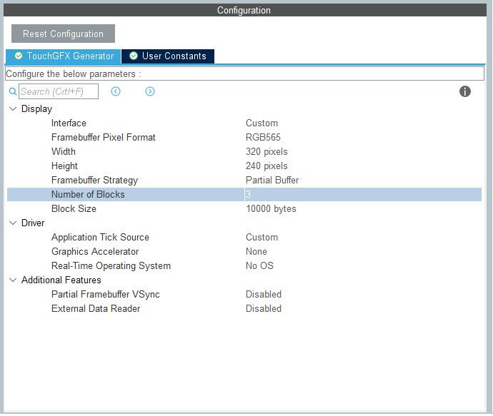

This is my setting of TouchGFX, I don't use LTDC. The LCD owns a controller (ILI9341). So I send data using SPI. MCU is STM32F407ZG. I call VSync function in a timer interrupt like below, also, I call the MX_TouchGFX_Process(); inside the while (1) loop. anyway, I don't think these steps are related to touch. I will investigate more.
to Vlau:
Do you have any success with that? Does your code run freely or freeze? Have you tried different TouchGFX options like RTOS on/off, buffer single/double?
Good point, however, I don't think it freezes, I will check again.
