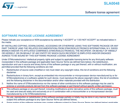

On the TouchGFX Product Page, go to the 'Documentation' tab:
https://www.st.com/en/development-tools/touchgfxdesigner.html#documentation
At the bottom is:
SLA0048: Mix Ultimate Liberty+OSS+3rd-party V1 - SOFTWARE LICENSE AGREEMENT
https://www.st.com/resource/en/license_agreement/dm00218346.pdf
At the bottom is:

You cannot port TouchGFX on other platforms or MCUs as it's an ST propriety.
If you try it, it cannot work because in the library there is a check at runtime if the MCU is an STM32 device or not.
If not there will be an error returned by one of the lib APIs and you cannot run the application.
