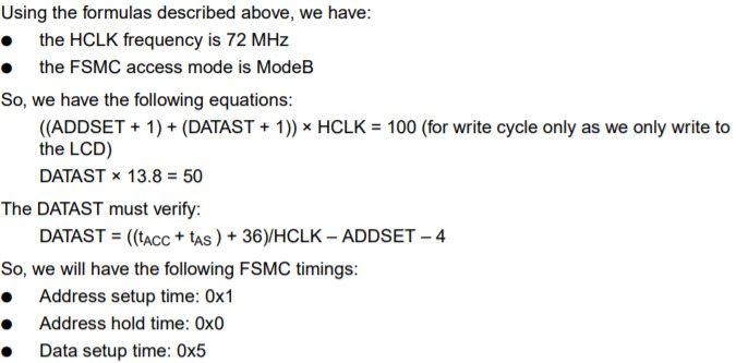

I have been stumped on this for a long time. My board is a Nucleo F767ZI, and my LCD is an ILI9341 8080 interface. The AN2790 note gives the following equations for asynchronous SRAM:

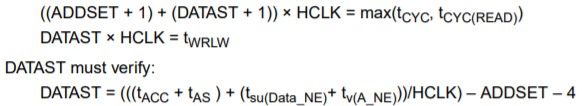

And the example they give for an SRAM with 100ns write cycle time:

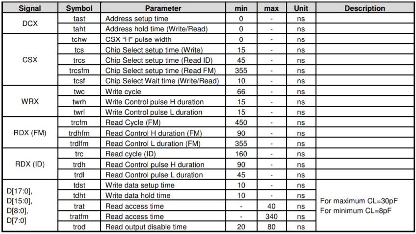

These are the 8080 timing constrains from the ILI9341 datasheet:

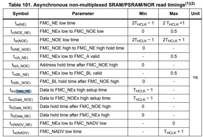

And here are the tsu(Data_NE) and tv(A_NE) ranges given for the F76xx series for asynchronous SRAM:
What's really throwing me off is tACC. The ILI9341 only lists data on max read access times, but I'm only concerned with write operations right now. And using the max frame access time gives me serious troubles:
Using an HCLK of 72MHz, and setting tv(A_NE) = 0 (If max is 0.5ns then I assumed I could set this to anything lower?):
Please help me understand where I'm messing up? I would appreciate any answers to these questions:

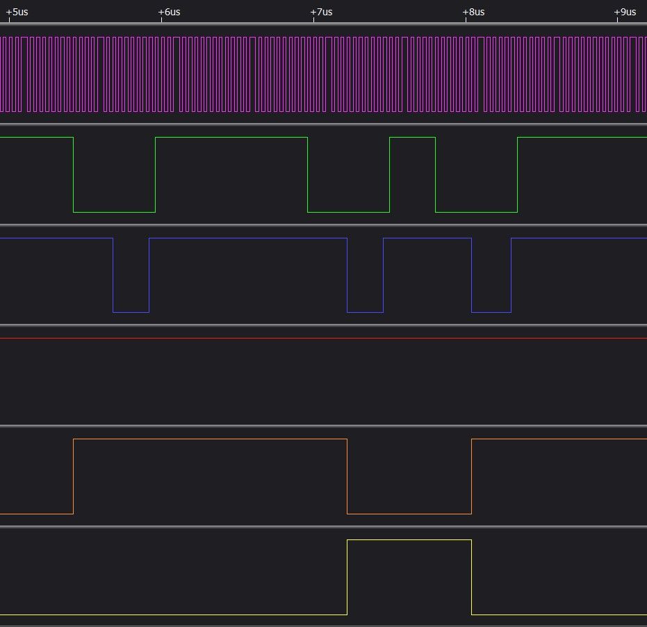

}Here's my new waveform when I call sendData(1); sendData(2); sendData(1); Hal_Delay(1);
(D0 is orange, D1 is yellow, NWE is blue, NE1 is green).
It still gets a little noise between the delays (not pictured), but not during the write signals, which is all I am concerned about.
I still haven't found the perfect configs to match the 3 equations, but the error might have been due to the missing data/writes the whole time.

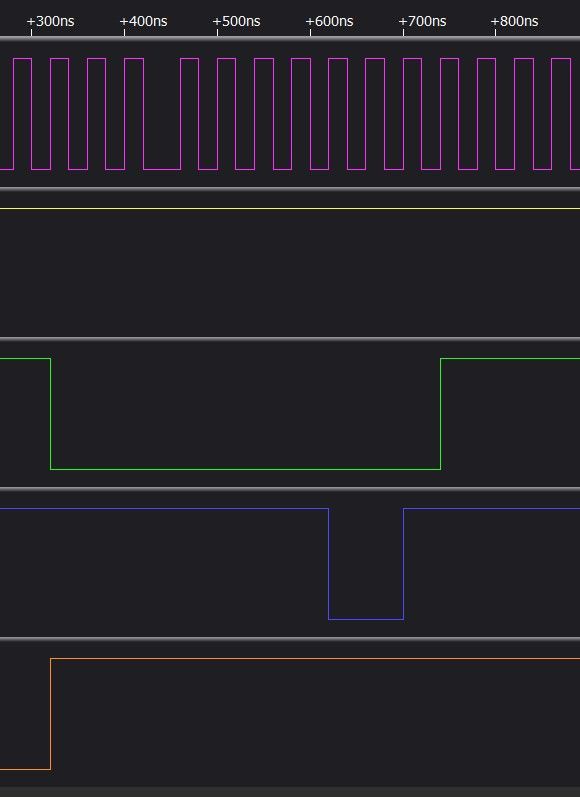

So I tried this out and it brought up a new question.
First of all, the ADDSET and DATAST seem to work correctly (purple = SYSCLK = HCLK = 24MHz, green = NE1, blue = NWE, orange = D0, and I have ADDSET=7, DATAST=2).
However, this was the code I was running:

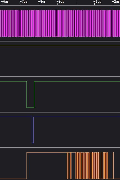

}And here is a wider view of the results:
The write signal only goes low once between every delay -- and I don't know what's going on with the D0 signal at the end. This is consistent across every iteration of the while loop, as far as I can tell.
So a question this brings up for me: I have my AHB prescaler set to 1 (ie, HCLK == SYSCLK). Is the program instructions / instruction pointer running off of the SYSCLK? Is the fact that I'm only seeing one write signal triggered a consequence that the FMC is running at the same speed, but that overall the write cycle is 7 or 8 SYSCLK cycles? Can the FMC not run at the same rate as SYSCLK?
Or, if that's not the source of the issue I am seeing, would you know what would be?

So I tried testing by setting the HCLK much lower than the SYSCLK but had essentially the same result. I also realized that my ADDSET and DATAST in the example above violated equation 3, but after changing ADDSET to 1 and DATAST to 5 I am still seeing the same issues.
The first two equations are intuitive to me. It makes sense that ADDSET and DATAST need to span the write cycle, and as you increase the frequency of the HCLK (and decrease its period), the more HCLK cycles you'll need to hold ADDSET and DATAST for to match the cycle time. And therefore I understand that the actual equation is
(ADDSET + DATAST + 2)*tHCLK >= tCYC
Instead of "equal to". However, I still have yet to fully understand equation 3 with the same intuition.

2020-05-19 11:54 PM
Data go threestate (floating), generally they tend to float towards zero (there's some leakage that way) so what you see as digital noise is the effect of your LA input being driven at around its decision level.
In 'F7 you see the caching effects until you do what you did in the last step, which is effectively setting the FMC as Device.
I don't intend to delve deep into what those formulas might mean, if you achieve the required waveforms with both single writes and sustained writes (also to alternating addresses, as you'll probably need that) you should be good. to go.
