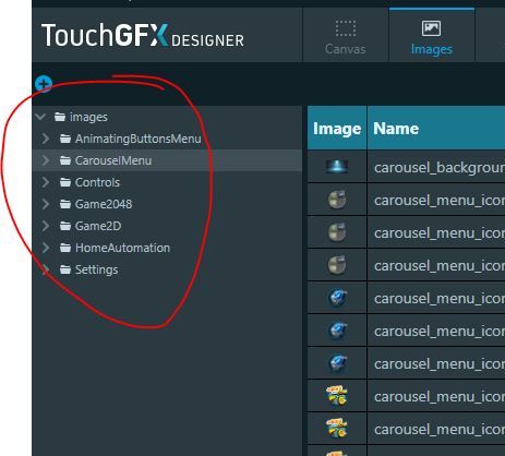

The Demo called "TouchGFX Demo2" has this folder organization.
I would like to realize this Folder organization:
How can I manage this organization on my project?

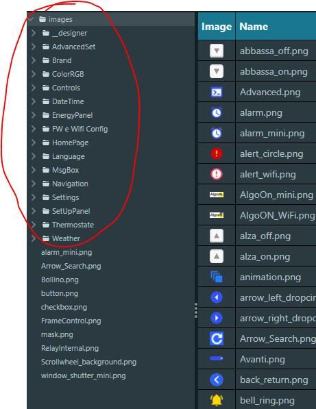

2021-02-25 12:34 PM
H Alexandre,
I tried the operation you said : it works but there is a big problem because the user MUST re-set all objects image properties (buttons, images, slider, containers... everything).
My hints is to semplify all this big work using the Designer... at least everytime you create a new Subfolder, properties changes themself.
TouchGFX designer can follow the image name, and when the user move this picture inside another folder the property can changes itself. If picture can't be found TouchGFX can highlight the error...
