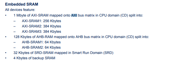

2022-11-28 9:03 AM
Your resolution and MCU power can do animations maybe too with single buffer only. Some screen transitions require triple buffer... And RGB888 is required only if you plan show photos or perfect gradients.
Plus need care SRAM isnt one piece 1,3M, but more parts. Only some usable with LTDC.
Accept all this your logic is correct.

Hello MM,
Thank you for confirming this. I did a quick search in the datasheet and found the following:
It does seem the AXI SRAM is broken into 3 parts. None of which are big enough, based on my previous calculation.
So based on this, it is not sufficient and external RAM would be needed, correct?

No correct, your framebuffer RGB888 is 382,5kB perfect for SRAM2 and second buff SRAM3 (kB = 1024B)
But you can use RGB565 or L8 based on your graphics.

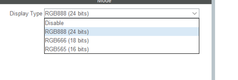

Hello MM,
Thank you! You've been an absolute life saver! I wasn't sure if you could separate the buffers like that.
When you say "use RGB565," is it as simple as just changing the setting? For example, if a display has 24 pins (R 0-7, G 0-7, B 0-7) for the RGB portion, can you use the RGB666 configuration setting in CubeMX?
In other words, can I use these interchangeably and the only difference will be picture quality?
