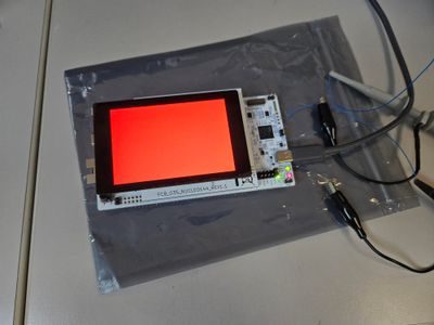

Hello. I am very very new to the world of STM32 microcontrollers and products. I've recently purchased the Nucleo-H563ZI board with RVA35HI Rev 1.1 display. I am starting slow, so to begin I tried utilizing the demo project in TouchGFX called "TouchGFX Demo 1 Alternate". After some troubleshooting, I've successfully flashed the demo project to my development board. The screen lights up white upon upload and I don't see the start up screen. Messing with it I discovered the project is uploaded, and still responding to touch because there is one screen that shows graphs, which for some reasons shows up. I've left the board in its default configuration as far as jumpers are concerned. I believe I have all required software downloaded. I've followed the instructions of some guides online and don't understand what I'm doing wrong.
Thank you.
See attached: Pictures of board lighting up, showing graph, and the simulator screen with the graphs.

It seems like I'm still running into the same problem.
Just for the hell of it I tried changing my programmer to "hardware reset" and that didnt change anything. Then I made a new project in TouchGFX to confirm the upload is working by changing the screen to a solid color (doesn't need to save to external memory) and that worked...

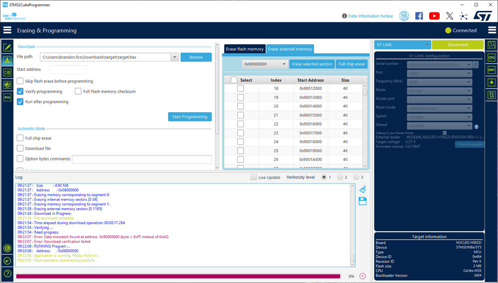

Last thing you could try is to write on ext memory using STM32CubeProgrammer directly (just try to put random value in memory range of 0x90000000) Remember to use correct ext loader.
If that doesn't work either, I would advise to contact Riverdi (and maybe ask them to change your screen).

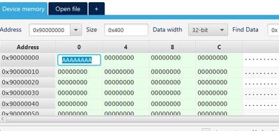

2025-02-25 7:53 AM
Writing to the flash locations didn't work. There is activity on the IO but the data is not taken.
As far as I understand the flash became write protected at some point.
Also if the flash is used in memory-mapped mode then only read operation is allowed.
There are posts that try to go into the status registers and clear bits but we are not familiar enough to do that.
Are there any project out there that can clear the write protect?
