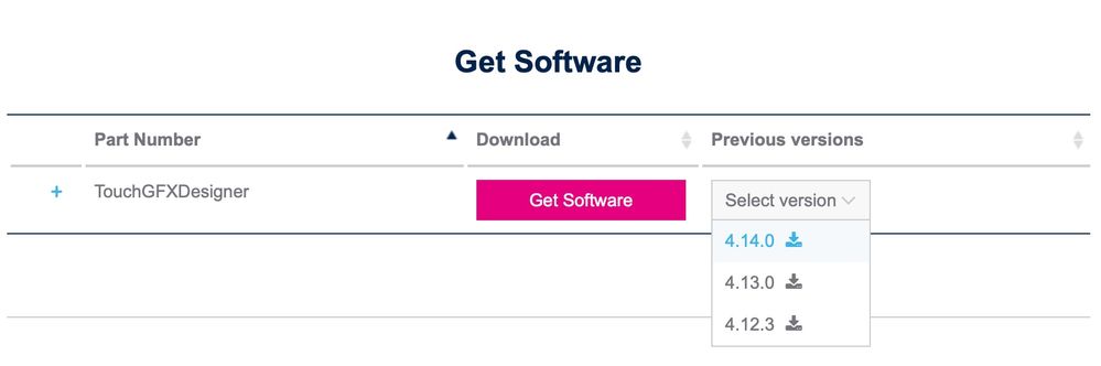

Where can I get 4.15 ?
The download is only shows 4.14.

Managed to install Designer 4.15 and got a button and new screen working on the simulator. Generated the code.
