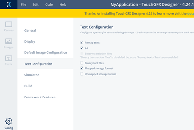

So the current setting in the project under Config tab in text is SET to unmapped storage format.
Yes., the text boxes are all set to visible.

2024-11-15 7:15 PM
It looks like the font glyphs are not being generated in the IntFlashSection. Please change back to Mapped Storage Format, build your project and attach your Map file.

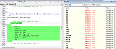

Hi @Michael K I have now changed the touchGFX setting to MAPPED STORAGE FORMAT and it gives a usage fault. Adding the snapshot of CPU register window and the map file in the zip.
Let me know., if any other suggestions/ settings have to be considered.

Hi All.,
In my application, the usage fault trap is enabled that is triggered at divide by zero and also when the memory alignment fault is observed.
By disabling the memory fault trigger that is enabled at the usage fault. I was able to get the fonts being displayed on the screen.
This solution helped me come at a conclusion saying that memory alignment at the Font data level is not correctly working at the touchgfx library level.
The core is M33 of STM32U575V is unable to handle it accordingly. Still working on it., as disabling the fault enablers at the handler is not the right way to handle the issue.
