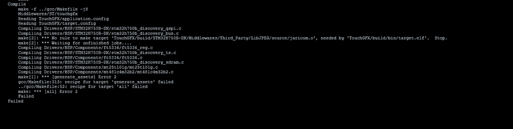

2023-01-15 3:00 AM
how can I solve this problem?
I already cleaned and rebuild the project but the error not missing
the error comes when I try to run the target on touchgfx bcs the error coming from touchgfx. stm32cubeIDE is okay and got no error.

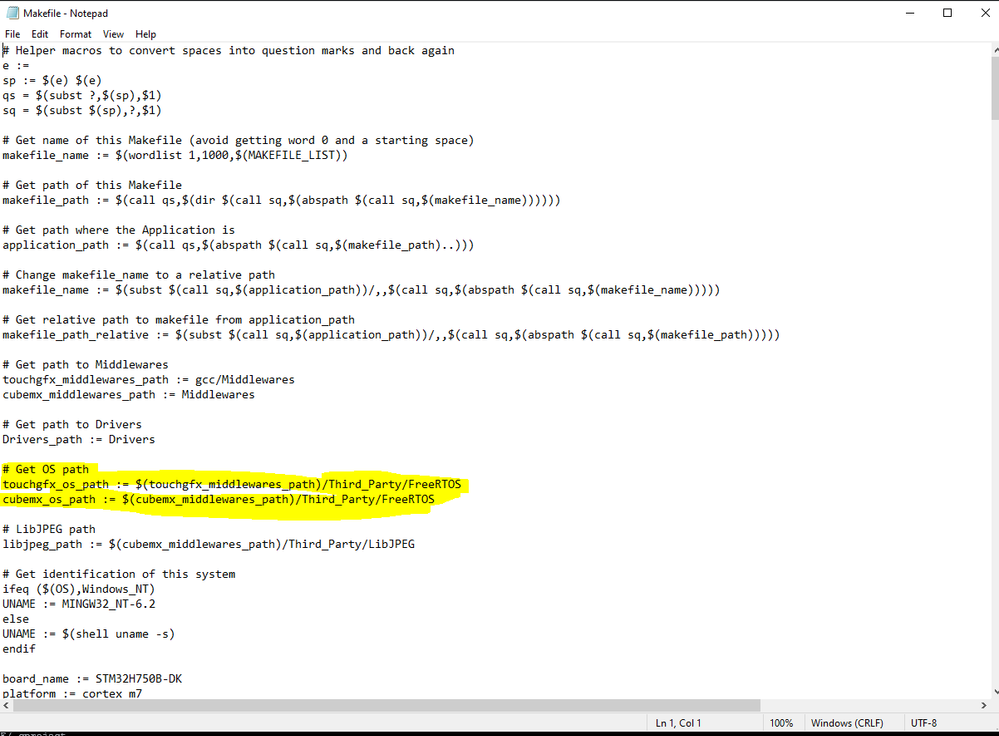

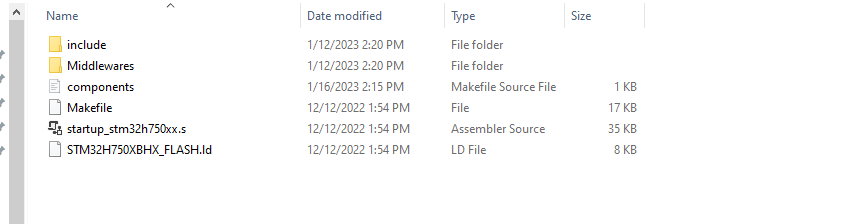

Ok that makes sense then :thumbs_up: When you try to run on target from TouchGFX Designer you use gcc (not STM32CubeIDE) with a Makefile we wrote ourselves, available in the <project name>/gcc folder. In this makefile we have added the paths and files to compile, running commands, etc... When you disable Freertos, the linked files and libraries "should" (I think) be removed automatically from your project. But since the Makefile is hand made, the changes in STM32CubeMX won't impact it. So you need to go and open that Makefile to get rid of the FreeRTOS related things like this Middlewares/Third_Party/FreeRTOS thing.
The STM32G071 nucleo project does not use FreeRTOS so maybe you could compare the Makefiles to see what should be removed (all OS related dependencies and paths).

Yes this Makefile :thumbs_up:
Delete those lines, but also the ones refering to touchgfx_os_path and cubemx_os_path, and all other things related to "os". I've tried cleaning this one (instead of deleting I just removed the path and files references), cant promise it will work but got rid of all i could think of.
/Romain

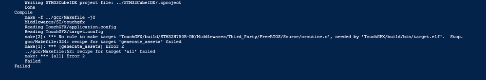

I run the target and got this error using the makefile you send
2023-01-15 10:54 PM
arh yes, do you need to use the video widget ? The error comes from what is necessary to make this widget work, linked to FreeRTOS in this project. If you dont need the video widget, then you can get rid of all those references as well (all the middlewares/third_parties)
