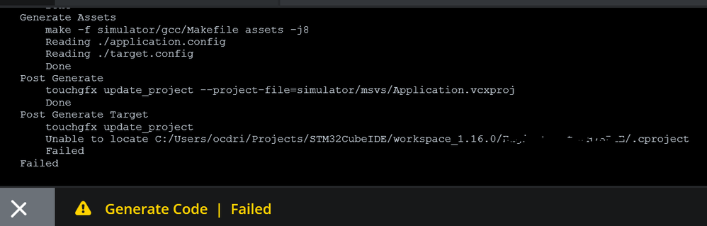

Beyond frustrating that I have to use linked files in STM32CudeIDE when coupled to TouchGFX.
Is anyone else as frustrated as I am? Does anyone have a work around or suggestion?
Generate a project for the STM32CubeIDE. Generate the project at the root:
And then when trying to generate the TouchGFX section you get this ***:
Same behavior for dual core MCUs. A year or more has passed and this simple error seems to have no fix in sight.
Great MCU. Powerful and feature rich. Would love to work with it, but this is just making me want to practice discus throwing.
2024-09-11 7:08 AM
Hello @Richard Lowe ,
As mentioned in our documentation, the "Generate under root" checkbox needs to be unchecked when you generate project for STM32CubeIDE.
For optimal project structure, navigate to Project Manager and select the following options for project generation:
- Application structure: Advanced
- Disable Generate under root (STM32CubeIDE only)
I'll try to ask internally if we could do something about project needing code generated under root. I'll get back to you as soon as I have more details.
