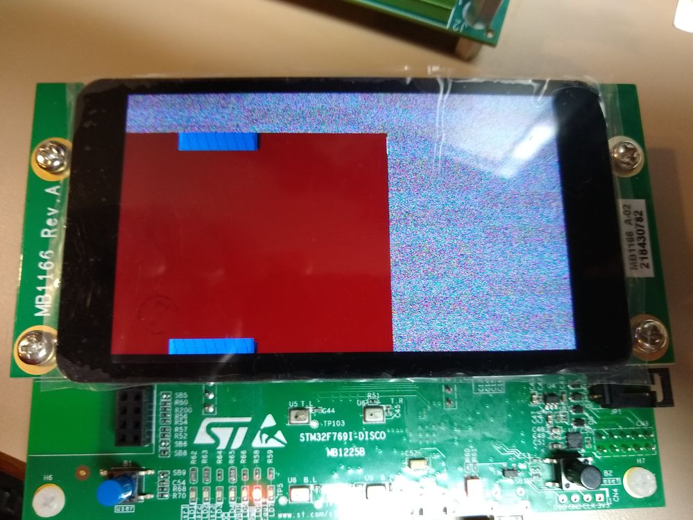

I tried to create a project with the new versions of cubeide and touchgfx. After disabling the watchdogs and SDMMC2, and programming with the st-link utility, it ran in the debugger. The output isn't what I created in touchgfx.
I noticed that this line wasn't present in the linker file so I added it. Nothing changed.
QUADSPI (r) : ORIGIN = 0x90000000, LENGTH = 64M
Thanks for any suggestions.

By some method of reading posts and comparing with the code generated by Touchgfx, I have the project working. The recent changes to cubeide and touchgfx designer don't enable the automatic creation of a working project for the 769disco as far as I can tell.
I need to figure out why the screen transitions are so quick, but I've attached the working project in case it might help anyone. Someone was nice and created this https://www.youtube.com/watch?v=237lPdMsDZs&feature=youtu.be so I've got the QSPI working now too.
