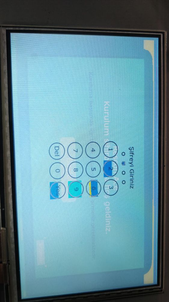

When I want to draw a box or something that can be drawable with code, screen working fine.
But when I want to draw an image from flash, screen go crazy.
You can see an example this situation;
What can you say about it? Is this can be fixed with software or we need to review our hardware?

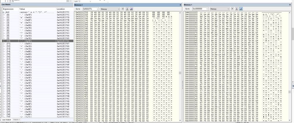

I have been working on it several days. I tested sram for make sure all bits working. I checked that the flash is programing correctly. I think problem it's coming out when system get data from flash to sram. I focus on DMA2D interface right now.
I add some picture of debug code. You can see memory section of flash that include a test image (Memory 2) and memory section of sram that include frame buffer (Memory 1) . And you can see _test array for this image in "Live Watch" window.
If you look image can see some irrelevant values in ram memory. You consider this is a sram problem but I need to say that, I tried fill sram with direct access and this worked fine. Because of that I thinking it's a DMA2D problem. But I can't prove it :)
