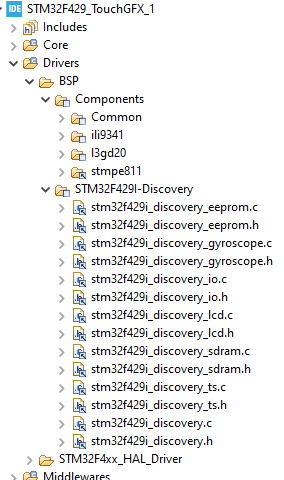

I want to create the TouchGFX demo 3 (the animated bubbles) for my STM32F429i-Discovery board by creating a new project within CubeIDE.
I'm a total noob to this STM32 stuff, but thanks to you folks here and on YouTube I've got it working apart from the touch feature. If I tap the screen on the button, nothing happens.
The hardware is fine as I have downloaded other demos (non CubeIDE ones) and they work OK.
Below is a walk-through of how I create the project ( sorry, its pretty long).
I created the project without a real-time OS, which I assume is OK for this demo.
Maybe someone can tell me what I've missed for implementing the touch control.
Using:
Board: STM32F429I-DISC1
STM32CubeIDE Ver 1.3.0
TouchGX 4.13.0
EDIT: DO NOT USE THIS WALK-THROUGH. See the one further down this post.

2020-02-28 1:28 AM
You're probably missing an implementation for your touch controller to propagate touch coordinates to the TouchGFX Engine (which distributes it to the active screen). Are you able to check if you have implemented sampleTouch() function for some class that implements the TouchController interface?
/Martin

2020-02-28 3:41 AM
Thanks Martin, That is exactly where I am needing some help.
I found in: <project_root>/TouchGFX/target/STM32TouchController.cpp
it created two empty methods:
void STM32TouchController::init()
* Initialize touch controller and driver
bool STM32TouchController::sampleTouch(int32_t& x, int32_t& y)
* By default sampleTouch returns false,
* return true if a touch has been detected, otherwise false.

Okay, this may be difficult to imagine, but CubeIDE/CubeMX do not help you with BSP (e.g. touch, sdram, display - e.g. the most recent post you made etc).
So what you need to do is use that touchcontroller code, find the Board support package for the 429-disco and include the *_ts.c file, at least to get access to the BSP_TS* functions.
You can take a look at the f429-disco application template from the designer to see which files are in that project.
/Martin

Exactly, just link (drag&drop) files from Firmware package, remove unnecesary ones...
This worked for me:

Thanks guys. My noob assumption was it copied all that was needed.
@JKlok Thanks so much for posting that code snippet.
I had the line:
BSP_TS_Init(BSP_LCD_GetXSize(), BSP_LCD_GetYSize());But the code crashed, ending up in function: HardFault_Handler()
But when I tried your line:
BSP_TS_Init( 240, 320 );everything worked fine :)
I turns out that the GetSize calls rely on LcdDrv which is currently pointing to NULL. I'll look into why, but for now I'm happy I have it functioning. Thanks.
