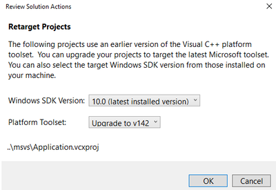

First I delete all files autogenerated by GFXDesigner:
Application.vcxproj.filters
Application.sln
Application.vcxproj Then I generate them again.
When I open the Application.sln, my MSVC IDE asks me to convert project files to my version of tools (Version 16.11.27)
After pressing OK the spaces are added to Application.vcxproj as I showed in my initial post.
