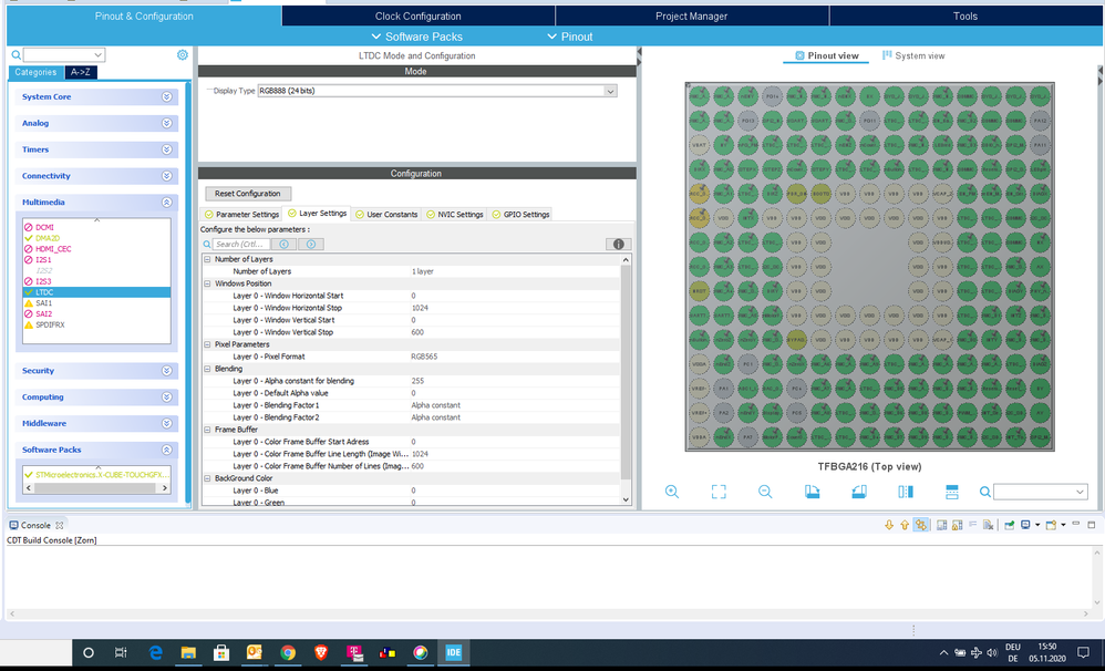

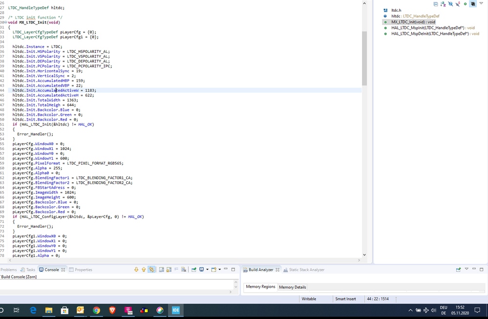

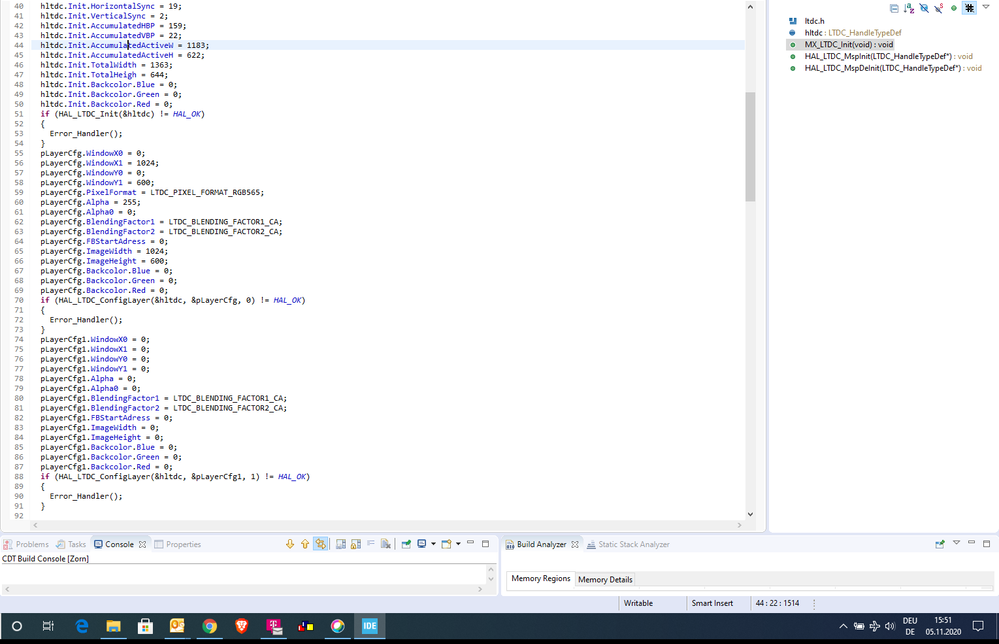

some thing is strange with the cube ide in the display controller LTDC initialization . i choose 1 layer only but the cube ide generate code for 2 layers!!
First time to see such thing
2020-11-11 3:23 AM
As a workaround , you need to delete the unnecessary code (the wrong config of the unused layer).

2020-11-05 6:47 AM
Hi @Community member
Could You please share you ioc file ?

@Khouloud ZEMMELI
Also there is problem with the touchgfx it does not set the resolution correctly always fixed at 800 * 480 and also the CUBE ide look change as you see in the photo

@Community member & @TWard.1 : Issue confirmed and now fixed, the fix will available for the next CubeIDE/MX release (1.5.0 - 6.1.0 ) which will be W47/48.
We are deeply sorry for any inconvenience this may have caused.

what is the impact and the workaround? It seems that this is causing my double buffering to not work properly and write to the other layer?
2020-11-11 3:23 AM
