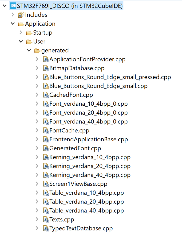

Regarding building errors in CubeIDE, if you have errors like this, first make sure that no ghost files are part of the project. It is especially true in the generated folder.
You will notice an issue because there are warnings beside the file(s):
You need to delete them by right-clicking > delete > ok.
I think the linker script is wrong because it is missing the declaration of the QuadSPI Flash. You will find enclosed a corrected version.
