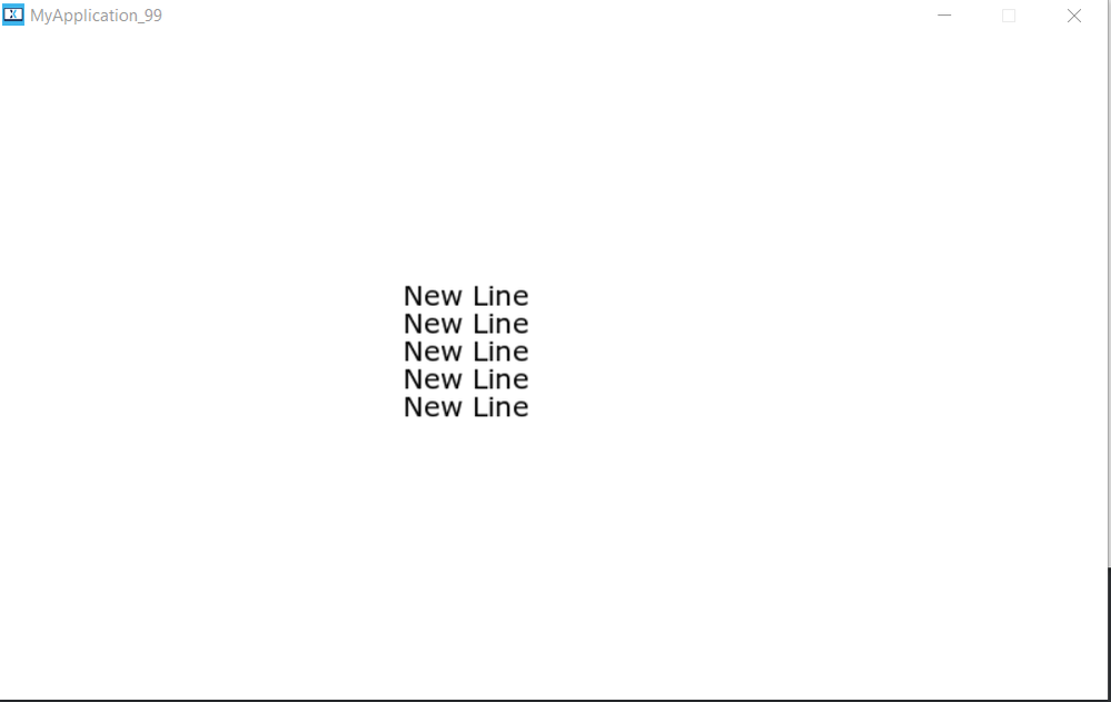

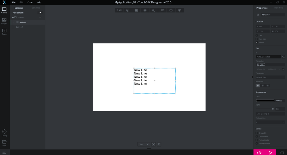

With LineSpacing 0 :

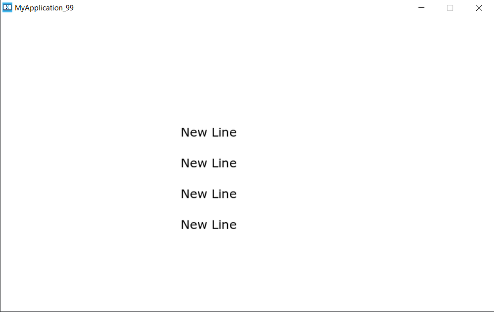

With LineSpacing 30 :
Can you show us some screenshots from your application ?

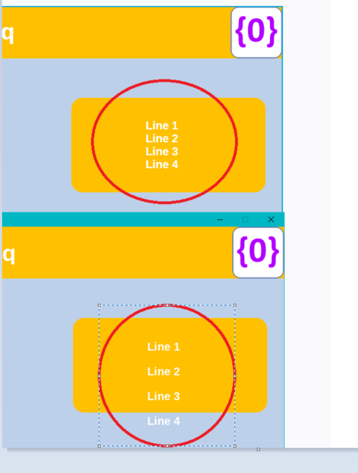

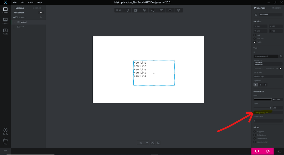

2022-06-29 3:15 AM
So it translates your spacing on the target but it's not visible in the designer. This seems like a bug since we can't fix the GUI without opening the simulator for every spacing change we do.

Yes you right, the "preview" of line spacing is not working. Thank you for your report. We'll try to have this fixed for the next version of Designer for sure. I'll keep you updated about this, and meantime, you can use the simulator to have this preview.
