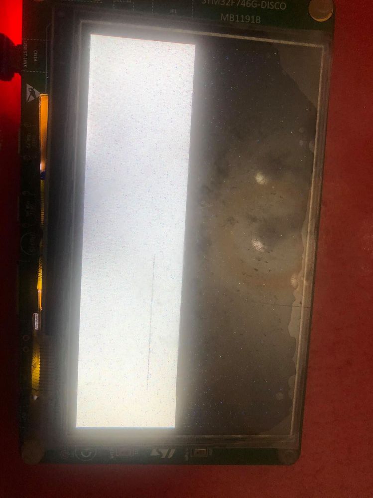

Touchgfx does not work for me, I get the pixelated screen I use stm32cubeide 1.4.0 it does not work for me download version 1.2.0 and also download TouchGFX V4.14 and nothing, change the version ==> V4.13 and still some help friend , I hope you can help me ??
I made a simple program in touchgfx and there it works, but the detail is that I use LWIP in my program, I need to use it from stm32cubeide

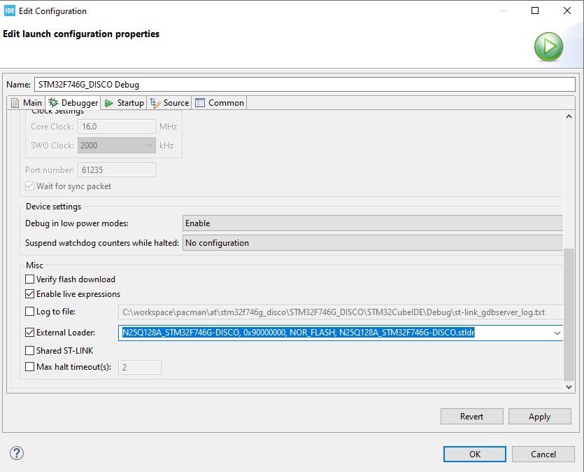

I looked at your project briefly and as Martin mentioned you haven't set the external loader for the F746-DISCO board in your CubeIDE project.
Here is the location where you need to modify it :

What are you expecting the application to look like? Is the External Flashloader configured properly for your project?

In CubeIDE the external loader is configured from "Debug Configurations", and you can choose the right external loader from there. It should be a part of the application template (.launch file has the info).
