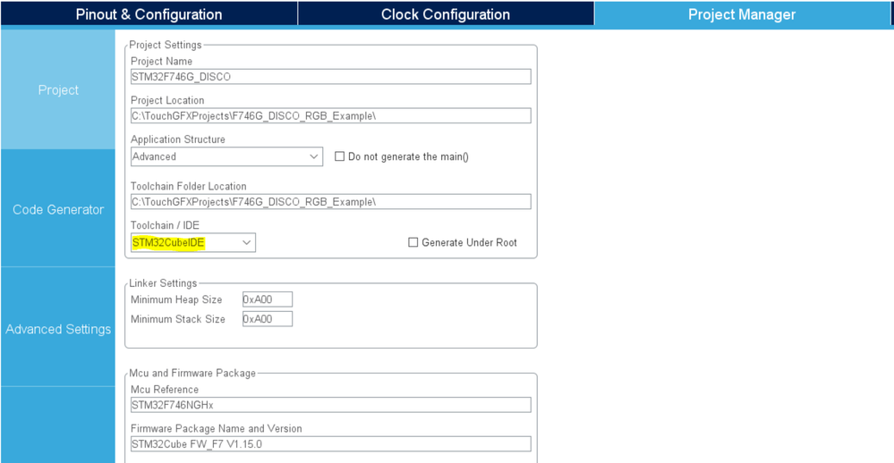

When you create a project the IDE by default is CubeIDE.
In order to make Keil compile, you need to specify in CubeMX (opening the .ioc file) the right IDE.
For that:
/Alexandre

2020-07-11 7:29 AM
For that:
/Alexandre
